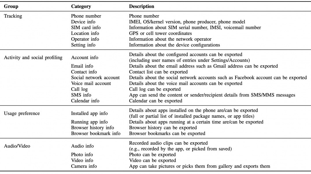

Therefore, it is pretty challenging to get a wide view of the information collected by those mobile apps. For instance, you may ask questions like how many apps on my smartphone collect private information, what kind of data these apps collect, which company processes and stores my confidential data, etc. We conducted a study together with researchers from Boston University where we investigated 22 categories of information that may affect the user’s privacy. Our goal is to address the above questions and understand worldwide private information collection on Android phones by analyzing the information flow (i.e., which app collects what information to which domain) generated by 2.1M different applications installed by 17.3M users over 21 months between 2018 and 2019. We listed them in Table 1 below:

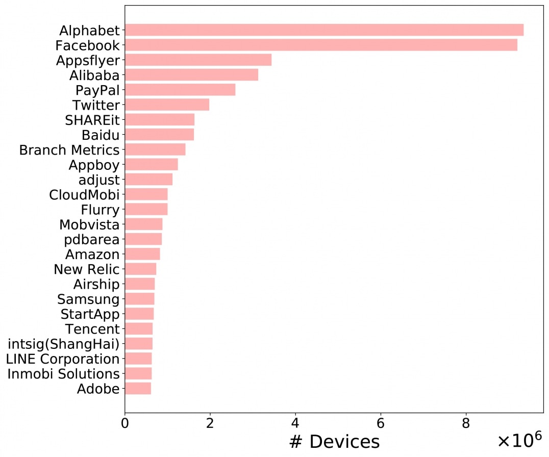

Figure 1. Top 25 data controlling apps ranked by the fraction of devices they collect private information from. These 25 data controllers collect personal data from 13.9M devices in total, covering 80.2% of all devices used in this study.

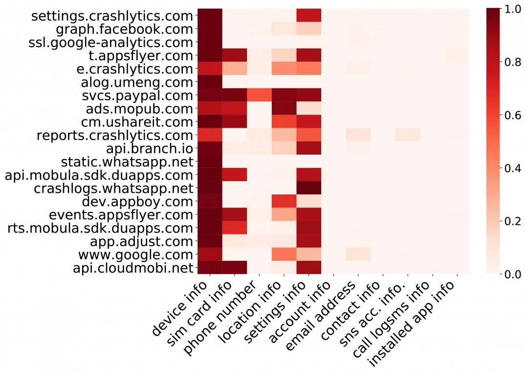

Figure 2. Heatmap illustrating global top 20 domains that collect top 12 types of private information. Each row is
normalized to [0, 1] by a PIC domain’s total device penetration rate. Darker red implies that more devices are distributing their data in a PIC domain (i.e., a public domain)
Who collects and processes private information?
We further analyzed who ultimately obtains and processes the information collected by the mobile apps. We used our authorized technology to reveal the domains’ ownership to which the private information was transmitted. These domains were then ranked by the fraction of devices they collect private information from. Figure 1 depicts the top 25 data processors and controllers. These data processors and controllers gather private information from 13.9M devices. Notably, 2 out of 3 devices would have their information collected by either Facebook or Alphabet. Figure 2 depicts the top 12 types of private data collected by the global top 20 domains. We observed that these domain companies consistently collect four types of personal information from the users - device, sim card, location, and settings information. These kinds of data enables them to track the users more systematically.

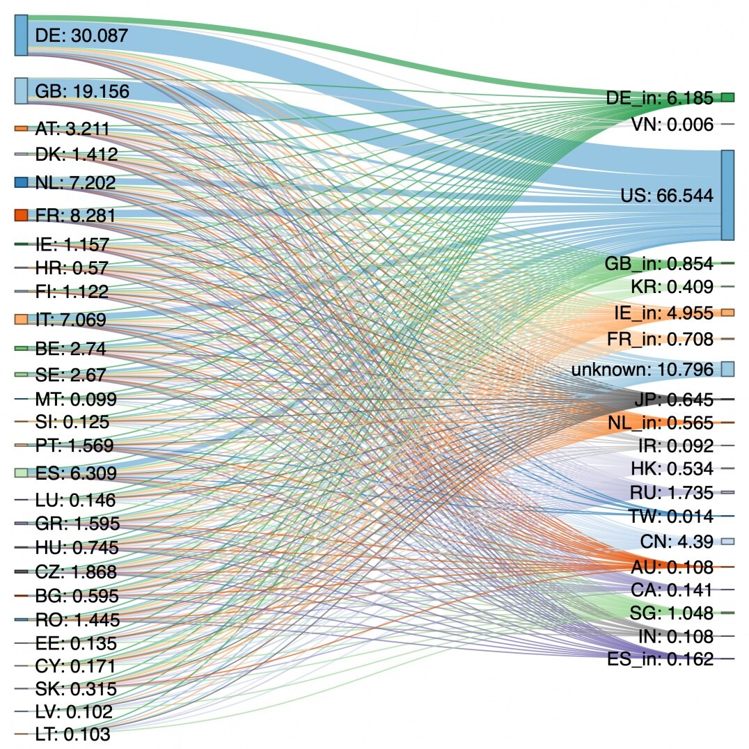

Figure 3. Sankey diagrams illustrating private information flows between EU27 (European Union) and top 20 domain locations.
GDPR and its impact on private information flow
The European Union’s (EU) General Data Protection Regulation (GDPR) entered into effect on May 25th, 2018.  However, the implementation of GDPR did not significantly change the flow of personal data originating from EU countries to countries outside the EU, see Figure 3. Our observations of these data flows show that confinement within the EU is low. Germany and Ireland are the only two European countries that host a reasonable portion of private information gathered from Europe. At the same time, the United States dominates the personal information collection in the EU.

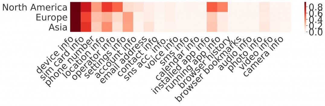

Potentially harmful applications (PHAs) could put users, user data, or their devices at risk (e.g., trojan and spyware infection, etc.).3 We identified 1.2M PHAs were installed on 3.8M devices. We uncovered that 116K PHAs (installed on 393K devices) collect operator information, and 63K PHAs (installed on 280K devices) also collect running app information on a global scale. As we can see in Figure 4, such aggressive private information collection behaviour enables adversaries to profile the users better and may lead to some intrusive advertisements. For example, we also uncovered that 590K PHAs installed devices are affected by notification bar ads (i.e., ads displayed as app notifications), and 317k devices suffer from short-cut ads (i.e., targeted ads placed on the home screen).
table_5
Figure 4. Heatmap illustration of private information collection by PHAs in different regions. Implications to the research community and the policymakers
