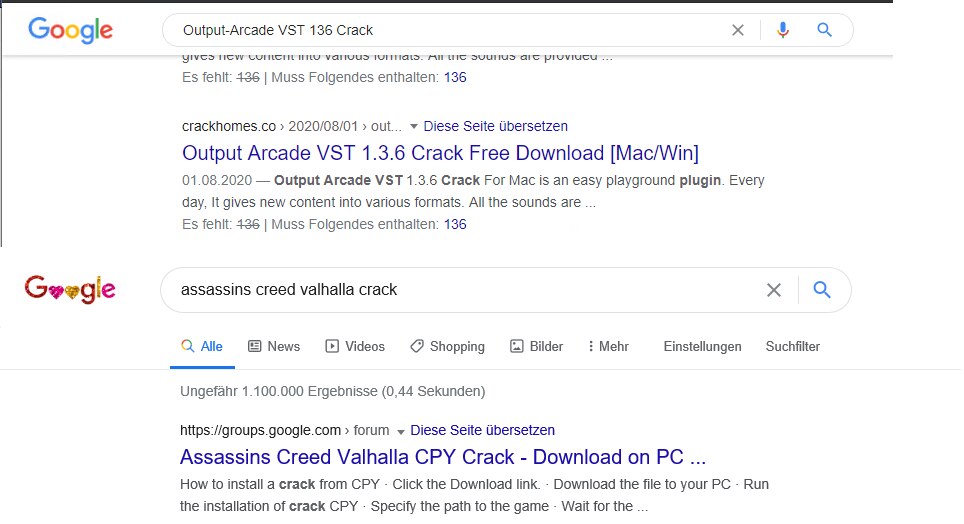

Most of the time, the first steps are taken by the users themselves. They might be looking for software cracks, game trainers, game mods, or license serial numbers is on Google or other popular search engines. From an attacker's perspective, it’s desirable to get into these top search results so that the user downloads malicious software instead of the legitimate one.
To do that, the attacker uses what is known as SEO – search engine optimisation. There’s nothing wicked about this because SEO is a common practice for gaining more visibility on the web, and most legal sites use this as well.
The attackers make their downloading sites visible by creating SEO-friendly tags and creating multiple pages with popular software tags. This enables their highly malicious websites to show up near the top of a regular Google search.

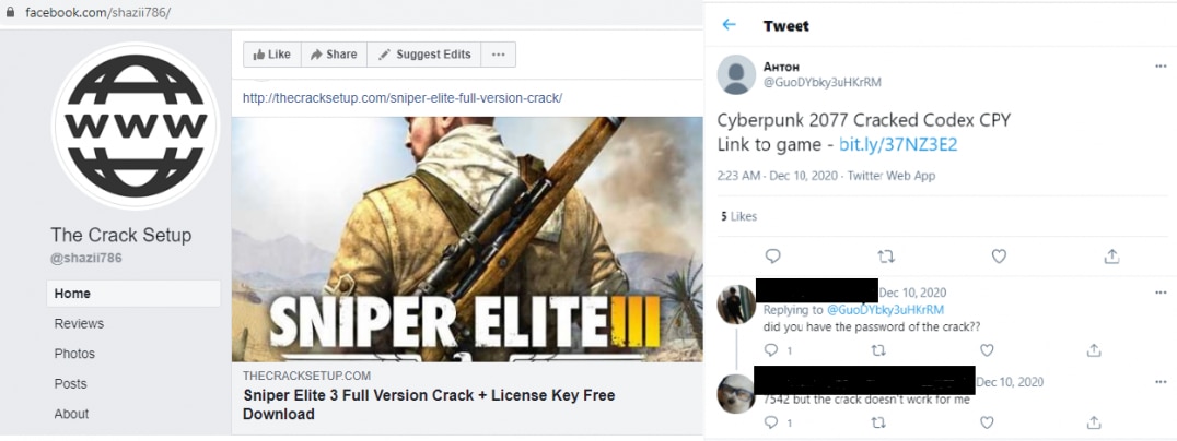

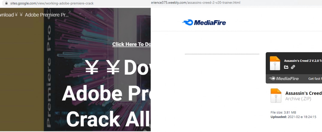

Usually, the final payload, or the malicious code, won’t directly be installed on a device just by visiting an infectious website. The user needs to click through one or more web fronts designed to look like the type of semi-legitimate websites that might be hosting cracked content. These frontline delivery pages include ads on popular social media sites like Facebook, Twitter, Reddit, and YouTube. 2
disguised_2
The main purpose of these frontline pages is to serve as a disguise to make it appear like a legitimate website. The primary process begins when a user browses the download URL to the final payload, or sometimes, the page just redirects you to another intermediate custom-designed fake website hosting the final payload.
Depending on the crimeware group, intermediate pages may or may not be present on the sites. Some groups are highly cautious about not letting their final payload interact with antivirus companies’ automated crawlers or other search engine crawlers. To achieve that, attackers add additional scripts to ensure an actual human is trying to download the final payload. Those methods are discussed in detail later in this article.
Intermediate pages are usually hosted either on free hosting services or private domains purchased by the attackers.

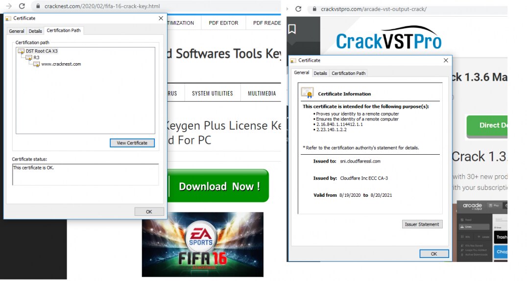

disguised_3

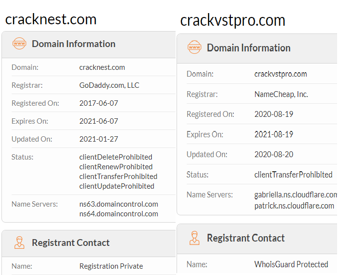

Figure 3: Intermediate private domain pages hosted over HTTPS Different attacking groups might use different hosting services. Registrations are privacy-protected
disguised_4
Attackers were observed heavily abusing legitimate free web-hosting services like Weebly, Google Sites, Wix, and Google Groups. An advantage of using free Webhosting services is that attackers can also use tools like SEO optimisation, which will ultimately help them in hitting top search engine results.

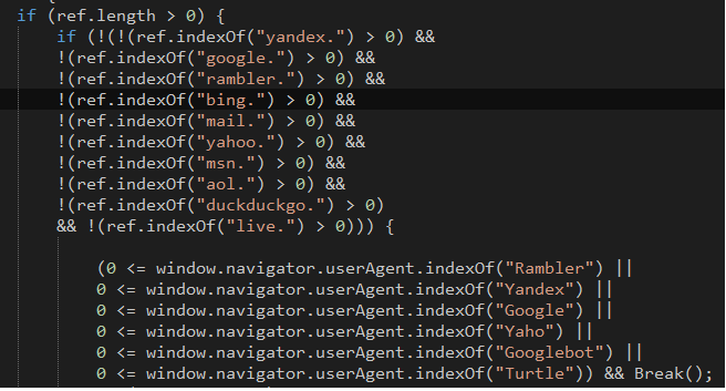

Referer Check:
Normally, requests to websites contain a referer field. This identifies which site the user came from before visiting the malicious page. That way, the attackers can check if the referer is a popular search engine before proceeding further. This will filter out many automated crawlers.
List of allowed referers are
  • Yandex
  • Google
  • Rambler
  • Bing
  • Mail
  • Yahoo
  • Msn
  • AOL
  • Duckduckgo
  • Live
User-Agent :
The next check is User-Agent. The User-Agent field is supposed to identify which process sent the web request (usually a browser). However, if the User-Agent recognises any crawlers or bots, attackers will simply skip the payload delivery. Below are User-Agents that the attackers have blacklisted.
  • Rambler
  • Yandex
  • Google
  • Yahoo
  • Googlebot
  • Turtle

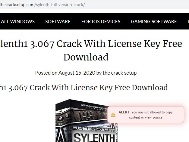

SourceCode View Protection:
This is a simple analysis-prevention trick where the website's sourcecode is blocked from viewing through a browser. This is done using a keyboard shortcut or through the context menu and is presented as an Alert message. Using alternative methods, we can still achieve source code.

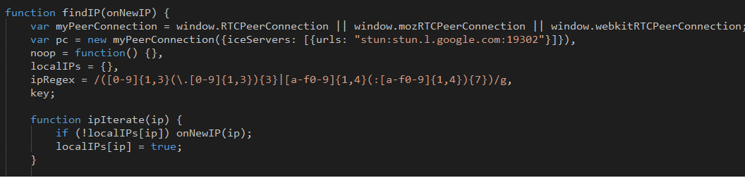

IP Filtering:
In this method, the attackers do not deliver the payload to the same IP address again. Attackers do this to avoid any other crawlers that bypassed earlier checks, and maybe to track victim counts based on geography. One crime group uses a Google STUN server to determine a victim’s externally visible IP address.

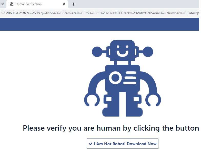

Captcha/I am not Robot :
Some crime groups implement the “Captcha/I am not a robot” function on their pages. This is yet another way to avoid crawlers and perhaps make the pages seem more legitimate and believable for victims. This was usually the last check before delivering the payload.

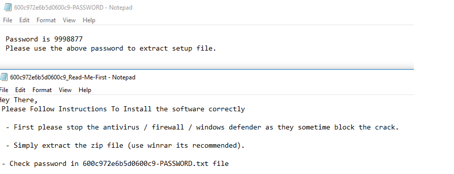

Password Protection & disabling antivirus:
Usually, the final payload is delivered in the form of a password-protected archive. The password will be part of the delivery or will be displayed separately. In most cases, they are not connected together. This is another way to prevent robots from getting actual content. Connecting a gathered archive and a password delivered separately is hard to automate.
disguised_10
The user may receive displayed instructions from the final payload to turn off antivirus and firewalls. This is a social engineering technique to trick the user into installing malware without being intercepted by the security software. This can be a very effective technique, as we have confirmed with telemetry.

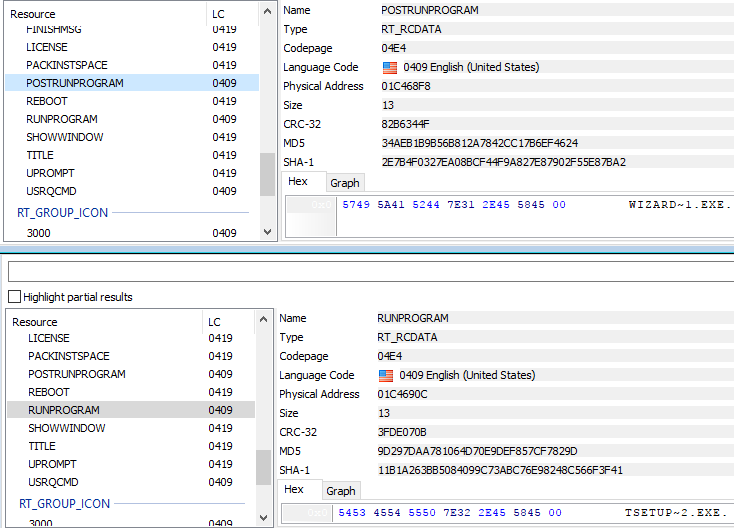

As mentioned, the bundle is a CAB SFX which uses two CAB SFX commands:
RUNPROGRAM – This command is used to execute the legitimate Telegram Setup, while the “POSTRUNPROGRAM” command is used to execute the RAR SFX mentioned below, which drops the ServHelper backdoor.

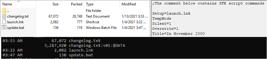

RARSFX Dropper
The dropper RARSFX mainly contained three files:
  • Legitimate file with the ServHelper dropper stored in DLL format in its Alternate Data Stream
  • BAT File – This starts the DLL in the ADS using files using rundll32.exe
  • LNK file – This points to the BAT file
The Setup command from RARSFX is used to start the LNK, which triggers the bat, and finally, the servhelper backdoor dll in ADS using Rundll32.

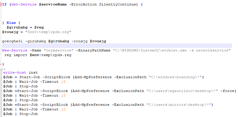

The malicious DLL is a 64bit UPX-packed executable. In its unpacked state, it’s a Delphi-based wrapper. We noticed no other behavioural changes from the second stage – it had the usual ServHelper Powershell Script, UAC escalation via SilentCleanup technique, the copying of wscript.exe, and maintaining persistence via TermService ServiceDll.
